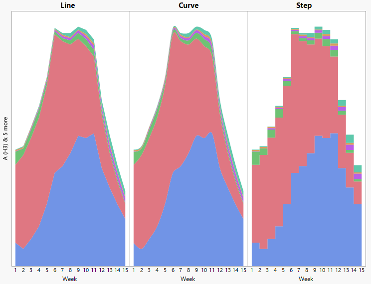

Area now supports all the same connection types as Line which are Line, Curve, Step, Centered Step, Horizontal and Vertical. Here are some examples showing Line, Curve and Step for the first 15 weeks of 2019:
Area Connection Type ExamplesArea Connection Type Examples
The Connection setting is available in the options on the Area element. Row Order is also supported for data with implicit row ordering.

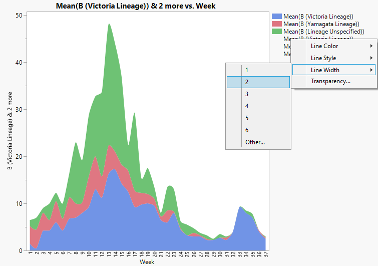

By default in JMP 15, the lines are displayed with a width of 0 on the Area element. This is a change from JMP 14, which displayed the lines with a width of 2 in the same color and transparency as the filled area. This had the effect of making the lines not visible. The lines could be made visible by changing the line properties through the legend.

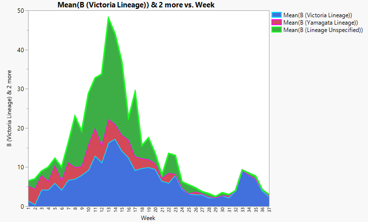

In the image below from JMP 14, the line color for each series has been changed to a different color and a Line Width of 3 in order to make the lines visible against the fills. Note that both the line and fill properties are shown together in the legend.
JMP 14 Line and Fill PropertiesJMP 14 Line and Fill Properties

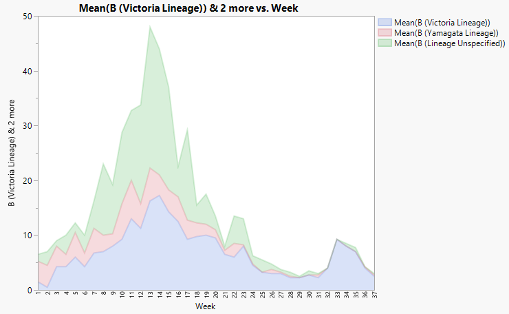

Unfortunately, the transparency setting controlled both the line and fill transparency. This made it impossible to have transparent fills with fully saturated lines. In the example below, the transparency setting on the legend has been reduced to 0.2. Both the lines and the fills have this transparency applied. The lines are slightly visible because they are drawn on top of the fills, but they are not fully saturated.
JMP 14 Area with TransparencyJMP 14 Area with Transparency

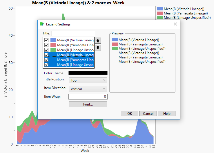

In JMP 15, the fills and lines are separated and controlled through individual legends. By default, the line legends are not shown since the line width is 0. To display the lines and the line legends, the line legends must first be enabled in the Legend Settings dialog.
JMP 15 Legend SettingsJMP 15 Legend Settings
In the Legend Settings dialog, enable the legends for the lines. These are the unselected legends below the fill legends. The preview does not display the lines because the line width is still set to 0. We adjust the line width once the legend is visible.
In this screenshot, the line legends are shown enabled and highlighted in blue:
Turning on Line LegendsTurning on Line Legends
Now that the legends are shown, use the right-click context menu on each legend to set a line width. The line is initially not visible because the line width is zero. Setting a non-zero width makes the line visible in the legend and on the Area element.
Setting Line WidthSetting Line Width
Now the outline of the fill area can be seen and is independent from the properties of the fill.
JMP 15 Lines and FillsJMP 15 Lines and Fills
To make the lines more prominent and the fills more subtle, we can adjust the fill transparency (or color) without affecting the line. In this case below, the fill transparency has been reduced from 0.75 to 0.2 as was done previously with the JMP 14 example.
The difference from JMP 14 is very apparent, as the lines are fully saturated while the fills are highly transparent.
Lines with Transparent FillsLines with Transparent Fills
