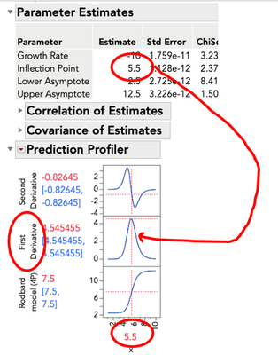

Keep in mind ALL non-linear models are solved iteratively. Other software packages may solve for the model parameters with less precision/lower convergence limits.
For relative potency, X-axis value should be log base 10 transformed. Some other software packages do this automatically without telling you.
See paragraph on Relative Potency:
Relative Potencies
Gives the potency and relative potency for each level of the grouping variable. The potency is 10^(EC50), where EC50 is the concentration at which the response half way between baseline and maximum is obtained. For the Logistic 2P, 3P, and 4P, the potency is 10^(inflection point parameter). The relative potency is the potency of one level of the grouping variable divided by the potency of another level. For example, in Figure 14.10, the relative potency of test A to standard is Potencytest A/Potencystandard.
https://www.jmp.com/support/help/en/17.2/index.shtml#page/jmp/test-parallelism.shtml%23
JMP's models and their parameters are listed here: https://www.jmp.com/support/help/en/17.2/index.shtml#page/jmp/statistical-details-for-fit-curve-mode...
Statistical details on derivatives for the non-linear platform in JMP (also used for Fit Curve).:  https://www.jmp.com/support/help/en/17.2/index.shtml#page/jmp/statistical-details-on-derivatives.sht...
