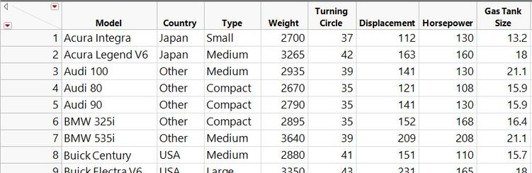

The first method uses the Distribution platform. Below is an example using the Car Physical Data.jmp sample data table. In addition to overlaying histograms, normal distribution curves are overlayed in this example. If you do not desire distributional curves in your graph, simply disregard the related steps. The structure of Car Physical Data, which has a total of 116 rows, is as follows:

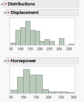

From the data table, go to Analyze > Distribution. Place two numeric, continuous columns, say Displacement and Horsepower, in the Y, Columns box and click OK.
The output will look like the following (I’ve removed some of the default output sections, like Quantiles and Summary Statistics, for simplicity):
If you see the histograms side by side instead of on top of one another, click on the red triangle menu next to Distributions and select Stack to see them as they are in the above image. If the histograms appear in a vertical format, click on the red triangle menus next to each variable name and choose Display options > Horizontal Layout. Another option is, rather clicking on each individual red triangle menu, to press the Ctrl key while making the change for one variable. By doing this, the change broadcasts across all other variables.

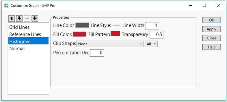

Now, I’ll go ahead and customize the colors of the elements in each plot so we can distinguish them in the final result. I will use red for Displacement and blue for Horsepower. Right click within the Displacement histogram and choose Customize. In the item list in the window that appears, click Histogram. Change the Fill Color to red and the Transparency to 0.5 (so we can more easily observe where the histograms overlap). The Customize Graph window appears as follows:
In the case for Displacement, the normal curve is already red, so we do not need to customize that item. Click OK to close the window.

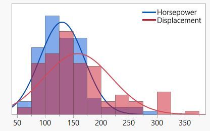

The result is both histograms and normal curves in one graph:
With this method, there is no automatic legend, but you can use the Annotate  tool to add text and the Line tool to add a colored line element for a manual legend.
After implementing these tools, my result is something like this:

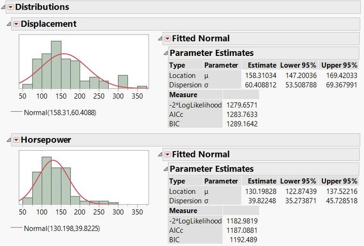

Next, I will overlay the normal curves. First, we’ll need to record the mean and standard deviation values from the fitted normal distributions applied to both Displacement and Horsepower in the Distribution platform. Recall that these values are given in the output after selecting Continuous Fit > Normal.
Recall the values (outlined in red) from the Distribution output below:

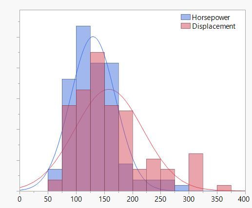

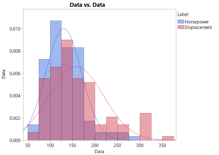

Click OK. The result is this:
Now, I’ll make a few customizations to finalize the graph to my preferences. I prefer to remove the graph label, the Y axis label, as well as the X axis label. I’ll double click in each field and use the delete key to remove the text. Also, I don’t want to show any tick labels on the Y axis. I double click on the axis to open Y Axis Settings and uncheck the Labels checkbox for major tick marks in the Axis Label Row section of the dialog. Also, I want to move the legend inside the graph. I click on the red triangle menu next to Graph Builder and choose Legend Position > Inside Right. Lastly, I’ll extend the range of the x-axis slightly for a more complete picture. I open X Axis Settings and set the minimum as 0 and the maximum as 400.
Finally, I click on the Done button and am left with the following graph:
