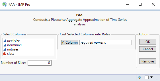

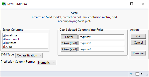

Two examples I have created using this add-in are the SVM and PAA (Piecewise Aggregate Approximation of Time Series) functions, which are shown below in addition to a video tutorial for the add-in. Please see the add-in documentation for tutorials, example add-ins, usage notes, and more detailed information.
JMP to R Add-In Builder Example: SVM (Support Vector Machines)JMP to R Add-In Builder Example: SVM (Support Vector Machines)
JMP to R Add-In Builder Example: PAA (Piecewise Aggregate Approximation)JMP to R Add-In Builder Example: PAA (Piecewise Aggregate Approximation)
