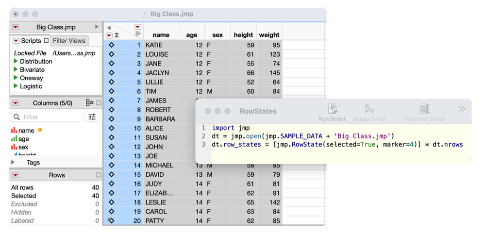

The jmp.DataTable object adds a row_states property to allow setting the table’s row states from Python. It simplifies the ability to copy the set of row states to a column or set the tables row states from a column.
