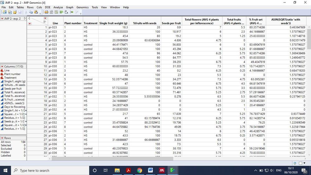

Hi, I'll explain..
I characterized BILs (Backcross inbred lines) for heat stress related
traits such as single fruit weight, seeds per fruits, etc. And I have their
genetic map (SNP map). I want to do SNP-Trait association in order to find
markers related to such traits. For each line (out of the BILs), I have 4
repetitions (ie. 4 plants per line/ per treatment: control/ heat stress). I
think that repetitions are good for getting a significant difference,
right? but I saw on your user guide just one value for phenotypic data to
each line. There is such a way to put all the repetitions?
Thank you so much!!
[image: BILs- traits.jpg]

Chris_Kirchberg
Staff
Hi @Neta,
The data table help. So it looks like you have an experiment of treated vs. control and then looking to model SNP-Trait associations taking into account this experimental variable (treatment).  I would include the Treatment variable in the Fixed Effects section of Model Variables tab, much like origin in the above blog example. I would use the combination of line and plant number is the individual identifier (unique ID for each individual plant)
You can include multiple traits (trait variables) in the trait variables section of the first tab (general) as long as they are the same type (Continuous, Binary, Nominal....). Each trait will be analyzed independently of the other, but for each trait, the treatment will be used to adjust the SNP-Trait association test ( a co-factor for each SNP being tested).
Look at the ? by each setting of the dialog to get more details as to what is expected and the impact is has on the analysis.

Hi, thanks so much for the help.
But I still do not understand how to insert in the JMP file several phenotypic data for each line (8 for example), when in the same file there is the genotypic information (SNPs in each marker) for each line in a separate line. Is there an option to insert the file with the phenotypic information not along with the genotypic information (SNPs)?
Chris_Kirchberg
Staff
Hi @Neta
You would join the two tables together if the information is in separate tables. One would need an identifier for each row in both tables to join the two data sets. For example, in your genotype data set, if you have line and plant number as two different columns and also the same columns in the phenotype data, you can use those two columns as keys to identify the rows that belong together.
You can use JMP's Join capability under Tables menu or you can use the Merge capability in JMP Genomics found under SAS Data Set Utilities. The later will be faster for larger data sets
Either way, you would need to save the result as a SAS Data Set for JMP Genomics to use in the SNP-Trait Analysis.

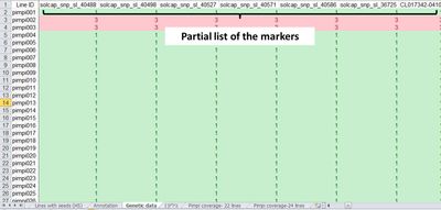

Hi, there is a misunderstanding between us
My question is how can in the same JMP file insert phenotypic information
of a particular BIL (Backcross inbred line) with 8 values (*8 lines*) for
the same BIL (i.e. repeats of plants- 4 plants for heat treatment and 4 for
control) and in the same file put the genomic information of each BIL with
its SNPs in each Marker - that is, each BIL is in only *one line.*
My question is not how to unify the data, but how can the two be unified in
the first place? I.e. one line for genomic information and 8 lines for
phenotypic information for the same BIL in the same file.
The second question, in the genomic file- the SNPs are listed as digits 1
and 3, 1 for the cultural parent and 3 for the wild parent. Do I have to
switch the digits to 0 and 2 (there is no heterozygote) because that's what
the JMP knows?
Thank you so much!!

Chris_Kirchberg
Staff
Hi @Neta,
So if I understand correctly, the genotype for each line (BIL) in the first image is the same for all 8 plants for that BIL. The second image is the genotype for each BIL. Is that correct?
Did you run the Trial where you randomized genotype and treatment? Or did you run two separate trials, one for heat and one for control?
Basically, you would have to perform an ANOVA on the phenotype data to summarize it first (get the differences in response for Heat vs. Control) for each phenotype for each BIL. That way you would have one value per BIL per Phenotype. Then you could join in the genotype data set and perform SNP-Trait association using the differences for each phenotype as the response or trait of interest (a change due to treatment). Even no change due to treatment might be of interest as well..
The ANOVA model would depend on how you setup the trial (or trials).
