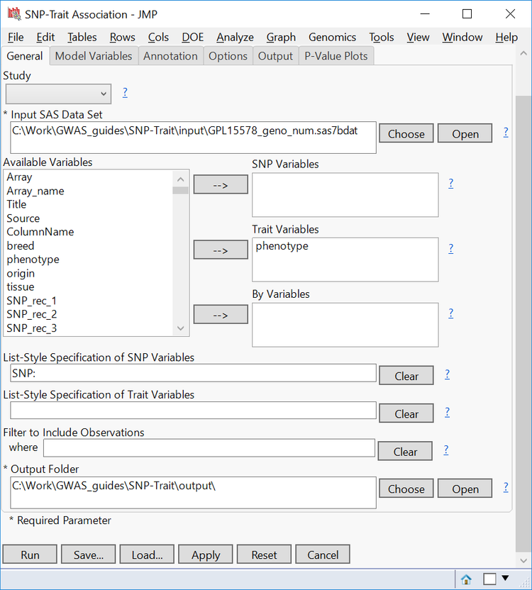

  1. From the Genomics Starter Select Genetics > GWAS Testing > SNP-Trait Association.

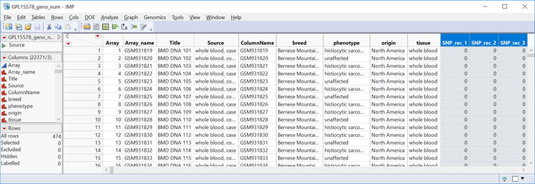

  2. In the General tab, select GPL15578_geno_num.sas7bdat as the Input SAS Data Set.
  1. In the box labeled List-Style Specification of SNP Variables, type “SNP:” to designate all columns starting with “SNP” as marker columns.
  2. From the Available Variables box, move phenotype into the Trait Variables Box.
  3. The By Variables box can be left blank.
    • When variables are placed in the By Variables box, a separate analysis will be performed for each unique entry for that variable.

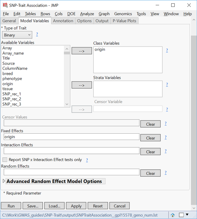

  5. In the Model Variables tab, select Binary as the Type of Trait. Remember, the phenotypic data for this trait only consists of affected vs. unaffected individuals.
  6. From the list of Available Variables, select origin and move it to the Class Variables
    • Class Variables are variables whose levels form distinct categories in the model. The origin variable, in this case, has distinct levels for the country of origin from which each sample came.
  7. In the Fixed Effects box, type “origin” to set the variable as a fixed effect.
    • Here, you can manually designate Fixed, Random, and Interaction Effects, as well as Advanced Random Effect Model Options.
  8. Strata Variables are selected to perform a stratified analysis on a binary trait. For this example, leave it blank.3_mod_vars.png

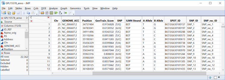

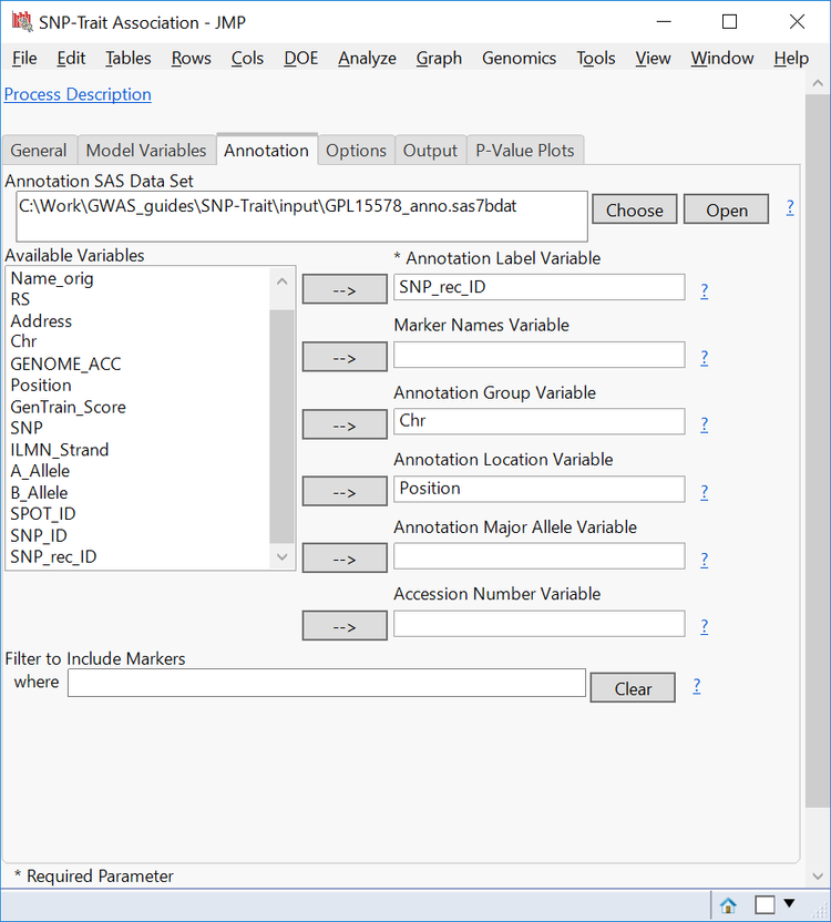

  9. In the Annotation tab, select GPL15578_anno.sas7bdat as the Annotation SAS Data Set.
    • This data set contains annotation information for each marker, like chromosome and position.4_anno_data.png
  10. Set SNP_rec_ID as the Annotation Label Variable. Entries in this column will be matched to SNP IDs in the Input SAS Data Set.
  11. Select Chr as the Annotation Group Variable. This variable will separate the results into different groups, chromosomes in this case.

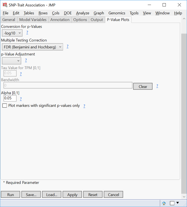

  4. In the P-Value Plots tab, keep -log10 as the Conversion for P-Values
  5. For the Multiple Testing Correction option, select FDR.
    • When performing multiple tests on the same hypothesis, FDR, or false discovery rate, will reduce the number of false positives.
  6. If you desire a p-Value Adjustment, one can be selected on this tab. For this example, no adjustment was made.
  7. Set the Alpha, the level at which a p-value must be for its associated marker to be considered significant, to 0.05.7_pval_plots_snpt.png

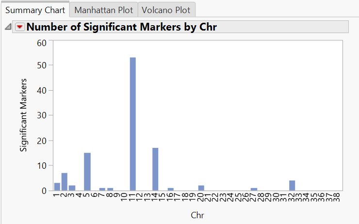

  1. When the analysis finishes running, the results window will appear showing the Summary Chart This tab shows the number of significant markers on each chromosome. 8_results_sig_markers.png

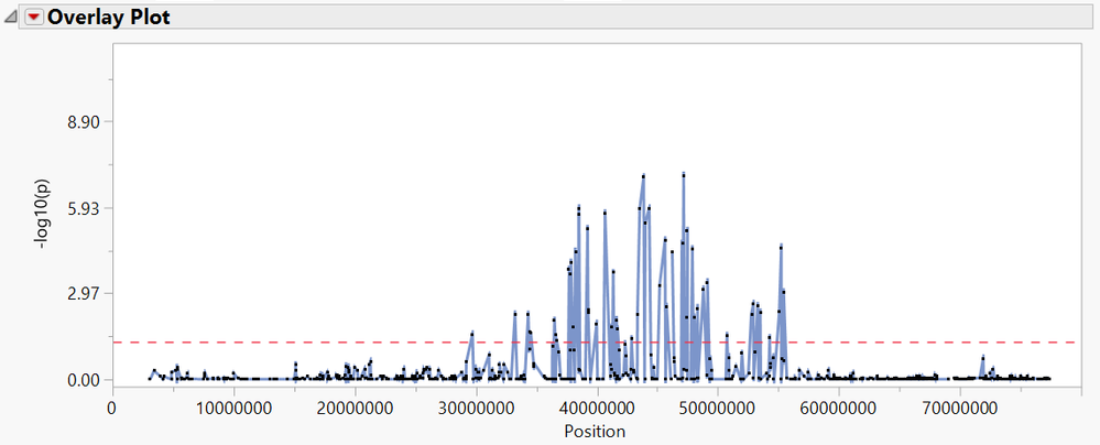

  2. Each of these chromosomes can be inspected individually by selecting one from the list under the Tabs heading on the left side of the window. Inspect chromosome 11 further by clicking Chr 11 Results.  Click View Tab to add the Chr 11 Results tab to the results window.
    • Notice the p-values for each marker are plotted by their position on the 11th This information comes from the Annotation Data Set added earlier.  Each of the markers that fall above the red dotted line (p = 0.05) are statistically significant.9_results_chr_11.png

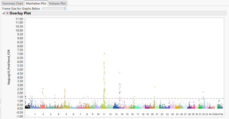

  3. The Manhattan Plot tab shows a plot of every SNP in the data separated and colored by chromosome number. The y-axis of the Manhattan Plot represents the statistical significance of each marker after the False Discovery Rate correction has been applied. 10_results_manhattan.png

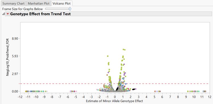

  4. The last tab is the Volcano Plot Each point on the plot is a single SNP, with the most statistically significant points appearing at the top of the plot.  The x-axis shows the fold change for each SNP, with more significant changes appearing at both far sides of the plot.11_results_volcano.png

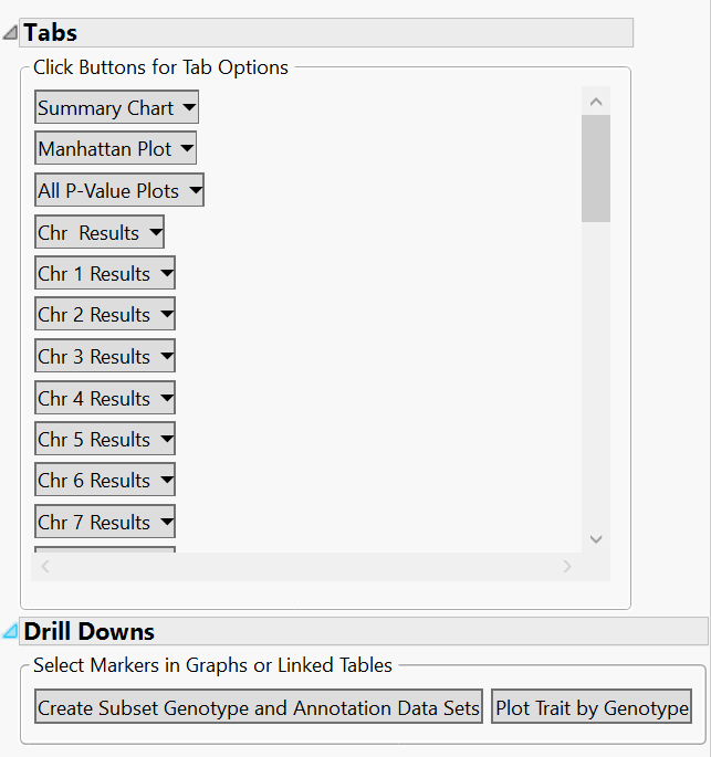

On the left side of the results window are Drill Down tools for analyzing markers of interest in further detail.12_results_tabs_drilldowns.png
  1. First, to create a subset of data, highlight the points on the plots from any of the results tabs, and then click the Create Subset Genotype and Annotation Data Sets button in the Drill Downs
    • Note that when points on one plot are highlighted, the same points will automatically be highlighted on the other plots.
  2. Highlight the two points in the volcano plot with the highest y-value, then click the Create Subset Genotype and Annotation Data Sets A new window will appear with three new data sets. One is the genotypic data from those two markers, one is the annotation data for those two markers, and the last is the other marker data that was not highlighted for the subset.

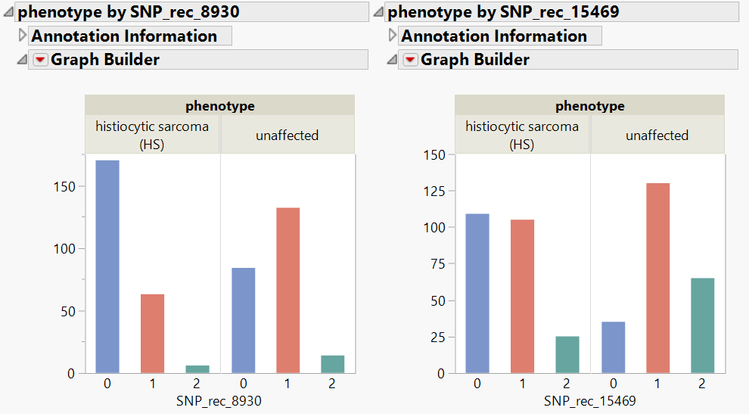

  5. Return to the results window and click the Plot Trait by Genotype for the two previously selected markers.
    • These plots show the distribution of genotypes for both affected and unaffected individuals for each of the markers of interest. The annotation for each of these markers can be viewed by clicking the arrow next to Annotation Information.13_result_geno_dist.png
