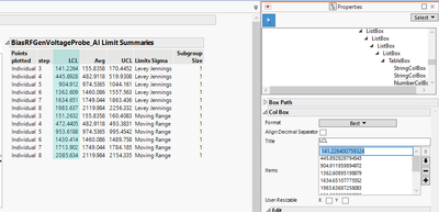

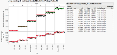

qli107493
Level I
Hello @tonya_mauldin
If I want to setup control limit for each different step, say my process has total 8 steps and each step 3~8 needs a different control limit, is there any easy way to set instead of manual input?
I figured I could manually change current LCL and UCL from column properties but this method seems to be time consuming.
tonya_mauldin
Staff
@qli107493 I suggest using the Get Limits method found in the following blog post.  4 ways to use fixed/baseline (historical) control limits in Control Chart Builde... - JMP User Commu...
