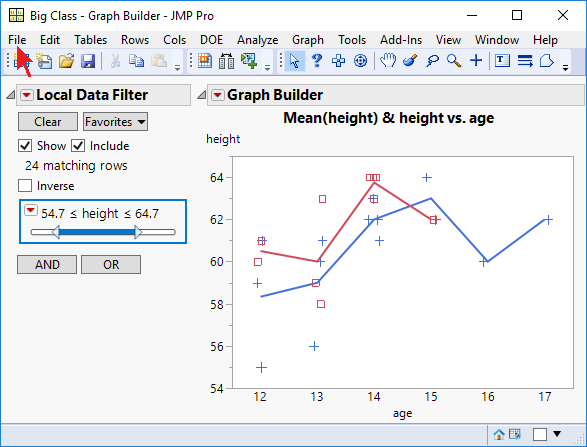

I have a graph with a local data filter which I like to convert into an interactive html dashboard.
I have no idea where File - Save As - Interactive html option is.
Are you talking on the main data table ... I don't see any html option under Save As
Under local data filter, Save as usually refers to script, data table etc.... again no html option
Can you be a more specific please ?
thx.

Hi,
The "File" menu is the first menu, at the top left corner of the window.
Choose "File: Save As...", and "Type: Interactive HTML with Data".
Thanks,
Heman.
altug_bayram
Level IV
Thanks for your help. I was able to locate "File" while in a Graph Builder mode. I wasn't aware of the hidden menu item in that mode.
So I was able to save my graph as interactive html

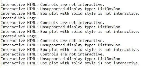

It said right at the beginning "interactive html is partially implemented... see Log"
Log contained...
heman_robinson
Level IV
Altug,
We display the "partially implemented" message when there is at least one feature that is exported to HTML5, but is not interactive.
Without seeing your output, I'd guess that the messages about Controls and ListBoxBox can be ignored.  The Box Plot "solid" drawing style, however, is not yet supported.  If you change to the default "normal" style, that should work.
If you are a frequent user of the "solid" drawing style, the best way to get it supported is to notify Technical Support.  They will open a ticket, and track all the customers who request this feature.
Thanks for your interest!
Heman.

lucy_luo_conoco
Level III
the interactive web report didn't work for me at all.
Interactive HTML: Controls are not interactive.
Interactive HTML: Mosaic cell labels are not supported.
Interactive HTML: Contour plot is not interactive.
Created Web Page.
heman_robinson
Level IV
Hi Lucy,
As with Altug's posting previously, not all features of JMP Desktop are supported in JMP Interactive HTML.
Judging from the Log messages, you are using a Contour Plot, which is not yet supported.
We add more features in every release, and will give this one strong consideration.
Thanks,
Heman.
