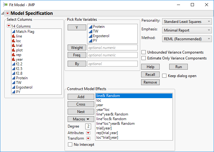

  1. Returning to the data table, select Analyze > Fit Model from the toolbar to construct a model.
  2. Select the four traits: Protein, TW, Ergosterol, and PY as the Y Variables.
  3. To add a model effect, select a variable from the list of columns on the left and select Add in the Construct Model Effects
    • First, select line as a random effect. To do this, Add line to the Model Effects box, once it is added, highlight it and select Attributes > Random Effect from menu in the Construct Model Effects
    • Next, add year and loc as effects.
    • To Cross effects, add the first effect, then highlight the effect in the Model Effects Select the effect to be crossed and click the Cross button in the Construct Model Effects box. To create a mixed effect for year and loc highlight year in the Model Effects box and loc from the list of columns and select Cross. The new effect will appear as year*loc.
    • For nested effects, add the main effect and highlight it in the Model Effects box, then select the effect to be nested from the list of columns and click Nest. To nest year in the trial effect, add trial as a main effect, highlight it as well as year in the columns list and click Nest. The effect will appear as trial[year].
  4. Add each of the model effects from the screenshot below. JMP will suggest a Personality, Emphasis, and Method which can be altered from the drop-down menus. Keep the defaults for this example and uncheck the Unbound Variance Components Click Run to begin the BLUP.2.Fit_Model.png

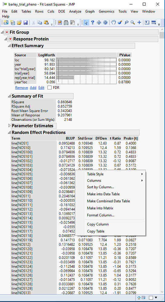

  5. When the model is finished, a new window will appear with model fit statistics for each trait. Under each of the traits, a table can be found under the heading Random Effect Predictions giving the BLUP for each of the lines.
    • To open each of these as a data table, right-click anywhere in the table and select Make into Data Table.
    • NOTE: To save the model to the JMP data table that was used to create it, click the red triangle next to the Fit Group heading and select Save Script > To Data Table… This will allow the model to be saved and re-run straight from the data table.3.BLUPs.png
