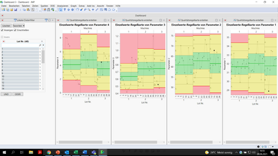

this would automatically update my dashbaord which in turn will calculated new limits.

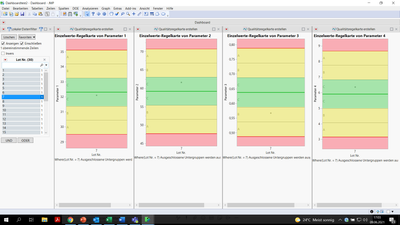

In this dashboard I now have the same problem I had with the earlier one, as limits will be calculated according to the Lot number I choose. Last time you help with the command to save the limits into the column properties, but this only works without a phase.
I can still get the old limits from the tables into the control chart of my open dashboard manually using the red triangle menu, but I have not see the possibility to do it with a script.
I other words how can I get the limits from the first control charts into my now updated dashboard?
And how can I get the dashboard to keep the limits no matter what lot number I pick? like I had it running in the other dashboard:
Here you can see I only picked one lot and still have all limits shown.
