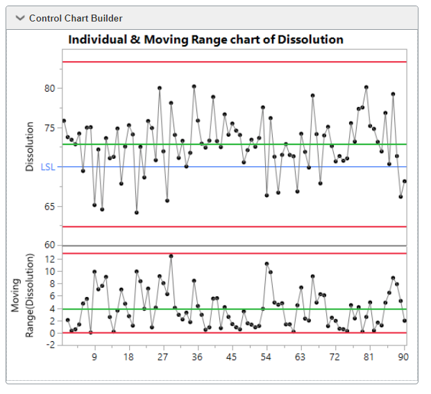

The Individual Chart (above, with “Dissolution” as the y-axis label) shows each unit as a black dot. The mean value of all these dots is marked as a solid green line. As all the dots fall within a 6-sigma range centered at our mean (indicated by the solid red lines), it looks as though our process is in control. Despite that, quite a few points fall below our Lower Spec Limit (the line marked LSL). How many? Let’s look to the Capability Analysis to find out.Although your production process may be in control, quite a few points fall below the Lower Spec Limit (line marked LSL). How many? The Capability Analysis in the JMP Live report tells you.Although your production process may be in control, quite a few points fall below the Lower Spec Limit (line marked LSL). How many? The Capability Analysis in the JMP Live report tells you.

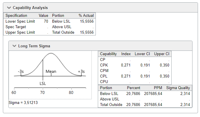

In the top left corner of the Capability Analysis, you can see how many units fall outside your spec limit (15.5556% in our case). The expected number, found at the bottom, is about 20.8% (based on the distribution of your data).  Maybe that’s fine, maybe that’s terrible, but at least you’re informed and can take some action if warranted. You decide to put your phone away and check again later as new data becomes available.
