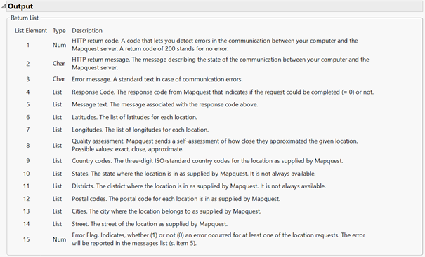

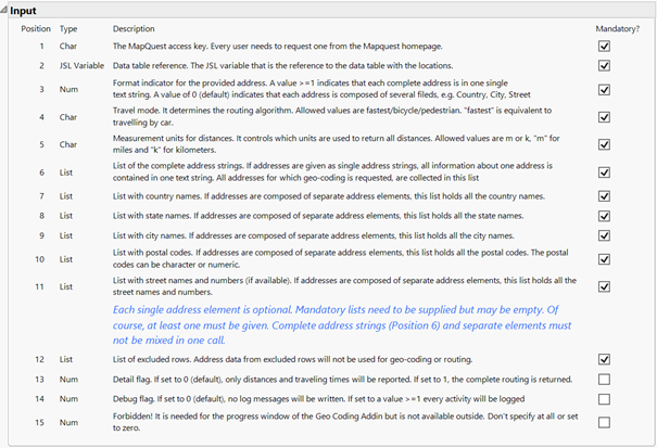

If the function needs or accepts parameters, they are listed in the brackets. This function, GC_geocode, can be called with empty brackets or with a full list of parameters. Calling it with empty brackets invokes a parameter definition window with an outline for input and output, as shown in these two graphs:
Parameters in a function call are always positional parameters. When the function is called with parameters, ALL mandatory parameters need to be supplied, but they may be empty.

First, you need an access key from MapQuest, let’s assume it is 1234ABCD. One way of using this interface is to take the address strings as they are. In this case, the format indicator (Position 2) needs to be 1 or larger. Then, the function call looks like this:
coordinates = GC_geocode ("1234ABCD", 1, {"Alte Freiheit 24a, 42103 Wuppertal, Deutschland",
"Schloßplatz 2, 42659 Solingen, Deutschland"}, {}, {}, {}, {}, {}, {});
If the addresses are in separate elements rather than in one string, the format indicator needs to be 0 (zero), meaning your call would look like:
coordinates = GC_geocode ("1234ABCD", 0, {}, {"Deutschland", "Deutschland"}, {}, {"Wuppertal", "Solingen"}, {42103, 42659},
{"Alte Freiheit 24a", "Schloßplatz 2"}, {})
Of course, you don’t need to put the values in as parameters; you can also supply a variable, e.g., a list variable with the list of country names.
In any case the result is the same list of data:
{200, "HTTP/1.1 200 OK", "", {0, 0}, {"", ""}, {51.25603, 51.13768}, {7.14865, 7.15245}, {"exact", "exact"}, {"DE", "DE"},
{"Nordrhein-Westfalen", "Nordrhein-Westfalen"}, {"", ""}, {"42103", "42659"}, {"Wuppertal", "Solingen"},
{"Alte Freiheit 24A", "Schloßplatz 2"}, 0}
Since the addresses could be found and tagged, the response code for each address is “0” (Element 4), which is why there are empty texts in element 5, where error messages would appear otherwise. The rest can easily be understood, given the interface declaration above.
