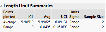

The blog post detailed creating a control chart for this data. The limits summary for the control chart is given below in Figure 1.Figure 1: Limits summaryFigure 1: Limits summary
 We want to use these baseline limits with new data.

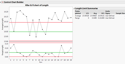

Create your control chart by going to Analyze->Quality and Process->Control Chart Builder. Drag Length to Y and Run to the subgroup role.
Figure 4: Control chart with fixed control limitsFigure 4: Control chart with fixed control limitsRather than calculating limits from the data, JMP used the fixed limits defined in the column properties. Note that the Limits Sigma says “User Defined” in the Limit Summaries table. We see that many points fall outside of the limits. Furthermore, the averages are higher than those of the baseline process. This process is different from the original process that we used to calculate the baseline control limits.

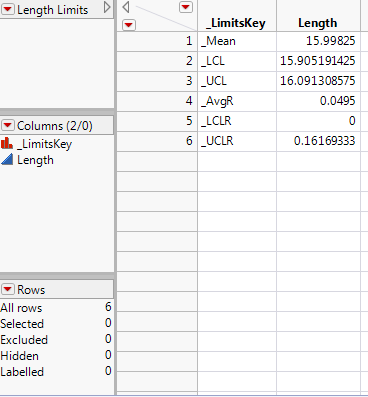

The Get Limits method is by far the most flexible method. If you have fixed limits for many different processes, you should use the Get Limits method. If you have different fixed control limits for each phase, you should use the Get Limits method. To use the Get Limits method, you need a data table that defines your limits.
A limits data table contains a minimum of two columns. One column must be called _LimitsKey. This column contains keywords that are used to define the limits. Additionally, you need one column for each process that defines the values for each of these keywords. These additional columns must have the same column name as the process of interest.
The keywords needed to define limits for the XBar chart are _Mean (for the average), _LCL (for the lower control limit), and _UCL (for the upper control limit). The keywords needed to define limits for the R chart are _AvgR (for the average), _LCLR (for the lower control limit), and _UCLR (for the upper control limit).
These limit data tables can be created by the old control chart platforms in JMP, or you can create them yourself using File->New->Data Table. In the future, Control Chart Builder will also be able to create these limit data tables.getlimits.pngCreate your control chart by following the steps given in the Column Property section of this blog. Click on the red triangle next to Control Chart Builder and choose Get Limits. Pick the Length Limits.jmp data table. You are presented with the same graph as in Figure 4.
