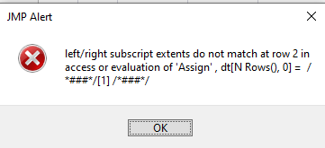

You can kinda do this already with data table subscripting (this is what I use from time to time, if I have to add values to ALL columns):
Names Default To Here(1);
dt = New Table("test",
	New Column("Col1", Numeric),
	New Column("Col2", Numeric),
dt << Add Rows(1);
dt[N Rows(), 0] = [1 2];
dt << Add Rows(1);
dt[N Rows(), 0] = [1];
Second one will throw because you are trying to add less values to the row than there are columns
With custom function this could be handled, but how would know from which side to drop values? Left, right or maybe middle? Or what would happen if data types do not match?
