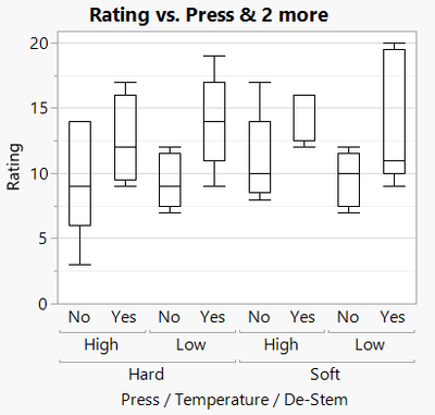

The feature in Graph builder to stack multiple information to a hierarchical structure is very useful.
But the way how it is implemented is just good enough to generate data on work level.
For publication or management meetings, it's way too complicated to analyze the axis title and convert the information to labels for the different levels of the hierarchy.
Hierarchical X labels
Especially if the labels of the variants don't give a clear hint for the used column:
What is the improvement you would like to see?
Please improve the way how the graph is generated!

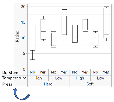

e.g.:
  • move the labels to the left
  • add some lines
Why is this idea important?
After the proposed optimization of GraphBuilder Plots with hierarchical levels on the axes,
no further postprocessing will be necessary anymore to use them for Publications and Management meetings :)

Lines can already be added from axis settings (Lower Frame and Long Divider as tick label) but I don't think you can move the titles. Axis tables already have "titles" on the left side
(but axis tables do not like when you change their tick label from table cell to long divider)
hogi
Level XIII
cool, lower frame :)
thanks.
So, let's hope that Jmp dev. will find this wish and will add an option to move the axis title in the next release ...
a small change - and such an improvement to understand the graph!

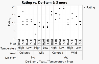

hogi
Level XIII

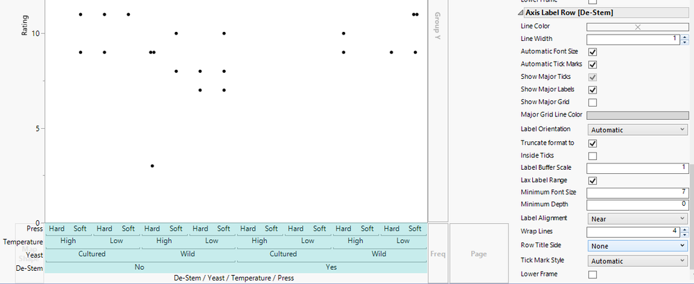

via Row title Side
universal script (till Jmp 18 is available to adjust it via the GUI):
(current report() << xpath("//ScaleBox"))[1] <<
			{Label Row( 1, {Tick Mark Style( "Long Divider" ),Lower Frame( 1 ), Row Title Side( "Start" ) }),
			Label Row( 2, {Tick Mark Style( "Long Divider" ),Lower Frame( 1 ), Row Title Side( "Start" )} ),
			Label Row( 3, {Tick Mark Style( "Long Divider" ),Lower Frame( 1 ), Row Title Side( "Start" )} ),
			Label Row( 4, {Tick Mark Style( "Long Divider" ),Lower Frame( 1 ), Row Title Side( "Start" )} ),
			Label Row( 5, {Tick Mark Style( "Long Divider" ),Lower Frame( 1 ), Row Title Side( "Start" )} ),
			Label Row( 6, {Tick Mark Style( "Long Divider" ),Lower Frame( 1 ), Row Title Side( "Start" )} ),
			Label Row( 7, {Tick Mark Style( "Long Divider" ),Lower Frame( 1 ), Row Title Side( "Start" )} )
jthi
ah.. I seem to have JMP17.0.0 and couldn't get any of the properties regarding AxisBox working from properties but they do work through scripting (properties seem to be still incorrect). Have to update to newer version
hogi
Level XIII
Yes, up to 17.2 it just works via Scripting
