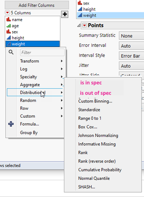

Both functions should be available via the right click "new formula column" menu.
Then users can easily generate new transform column on the fly in every platform - to group and add color to specific data points.
