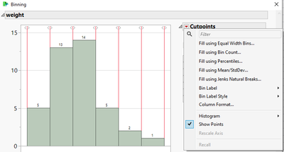

Custom Binning is a very cool platform. It's super useful.
Thanks @Jeff_Perkinson !
I have to admit - from all the binning schemes, 50% of the time I use Equal Width - and 49% of the time, I define the values manually.
Among the 49 percent,
most of the time I want to process a column with spec limits and mark rows which are out of spec.
What is the improvement you would like to see?
If a column has a  property Spec Limit, in the Custom Binning Platform please add options for the two cases:
1)
  • "in spec" and
  • "out of spec".
2)
  • < LSL
  • in spec
  • > USL
