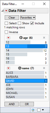

deficiency of Conditional Data Filters
View more...
Conditional in this Data Filters means that "age (1)" defines the items which are displayed in "name (2)". --> cool
Clearing the selection in age clears the selection in "name" -> not cool : (

Please add a control in the red triangle menu and via preferences to enable an alternative mode:
!! lock childs when clear !!
The new behavior:
If a selection is cleared via
>> the selection in child filters should not be reset anymore  <<
(sure: the row selection should be adjusted to fit to the displayed selection)

A) The new lock childs when clear  mode allows a very cool way of selecting rows:
View more...
  1. use a parent filter to select rows with interesting features, e.g. pass/pail = fail
    with "Conditional" activated, other filters will adjust accordingly
    e.g. batches will just shows batches with fail units
  2. select all these batches
  3. clear the filter selection for pass/fail
    you just filtered all batches with fail chips
Once you understand the magic behind it, it's a feature you won't want to miss.
This way, during exploratory data analysis, you can  "stay in the flow" , just make one step after the other.
No need to create a column formula with grouped Col aggregation or similar workarounds.

The current "clear all child-selections" mode for conditional data filters results in long graph rendering times:
Every time a selection is cleared, all child selections are cleared as well. No chance to restrict the plot to a subset!
So, every the  user has to wait dozens of seconds, or even minutes.
I often work with large data sets which can just be displayed efficiently if a subset is selected (!).
The current behavior of Conditional Data filters is so time consuming that I decided to deactivate it.
Same for you?
The lock childs when clear mode will fix the issue:
With the new behavior, the user can make a "dummy" selection (just a single row), clear all the other data filters, apply a new filter and then clear the dummy selection.
What an improvement! right?
