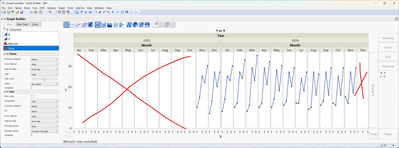

With nominal values on the x axis and X group activated, the axes of the sub-plots share a common list of values.
All plots show all values.
In the example below, X group says that girls are in the left plot and boys are in the right plot.
But due to axis sharing between both subplots, boys and girls show up on the axes of both plots.
This is counter-intuitive and consumes unnecessary space.
With some steps the underlying data table can be changed to generate a plot with girls just on the left and boys on the right:
https://community.jmp.com/t5/Discussions/X-group-gt-adjust-axis/m-p/542262
Would be great to have a right click option to directly "disentangle" the axis settings such that each axis gets (just) its own values.

It would help out the new page "row" option as well as you can split out the different levels to be on their own Y axis but unless you are using a continuous Y axis you still have the same gaps in the X axis.
Here the Page is arrange by two rows and the x axis is the lot number.  Each panel is by the part number.  Each panel should only respect the lots associated with it.
I have to switch to a continuous X axis to make it useful
