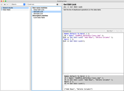

With the release of JMP 16 the Get Edit Lock message now returns a list as suggested above.

Does not work unless Set Edit Lock() is used first. If Get Edit Lock is run on a data table that was already locked when it was opened, or locked through the red triangle button, Get Edit Lock() returns Empty().
