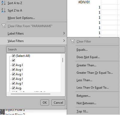

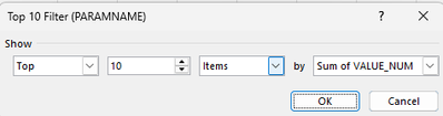

What is the improvement you would like to see? I would like to be able to sort the data inside the platform just like I would be able to if the analysis was made into a data table. So this would not only be sorting by a single column but being able to sort by multiple columns. Also, there needs to be the ability to scroll lock the columns and rows for when your table gets larger as well as have the control panel be always visible so allow easier manipulation of the table when it grow tall or wide. Finally, in Pivot tables you can filter the values by either label or value filters and while a lot of this can be replicated with the local data filter there is not the ability to show just a ranking of values, which you have the option of in excel. If I use the Top 10 function I can just show certain levels by summary statistics from a chosen column.
This would be a very value option to limit items shown but a value other than count of rows. (this options would also be amazing to have for graph builder as a more flexible function than the current "configure levels" option)
