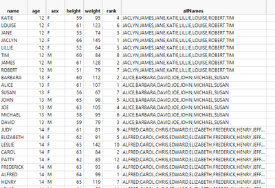

Up to now, I used Split to sort the entries, combine them and merge them back to the main table:
Names Default to Here(1);
//-------- dt << new column ("rank", Formula( Col Rank( :name, :age ) )); // put names next to each other, grouped by age DTsplit=dt<< Split( Split By( :rank), Split( :name ), Group( :age ) ); // Combine columns to a linge column DTsplit << Combine Columns( columns( :"1"n, :"2"n, :"3"n, :"4"n, :"5"n, :"6"n, :"7"n, :"8"n, :"9"n, :"10"n, :"11"n, :"12"n ), Column Name( "allNames" ), Delimiter( "," ) );
//----- // Update data tables dt<< Update( With( DTsplit ), Match Columns( :age = :age ), Add Columns from Update Table( :allNames ), Replace Columns in Main Table( None ) );
to get:
If Summarize had an option to concatenate strings, the whole part between the //---- could be replaced by a simple Summarize.
