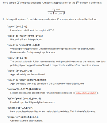

Unfortunately, my approach was wrong.
Cumulative Percent is NOT Cumulative Probability [%]
it is:
What is the improvement you would like to see?
Please add Cumulative Probability as an option for Summary Statistics in Graph builder.

The Rank [%] will allow users to easily generate grouped Cumulative Probability Plots in Graph Builder.
Compared to the more complicated approach with the Transform Column it will have the huge benefit that a Column Switch can be used to cycle through different columns.
