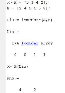

        Thank you. Also an update to our previous conversation, I don't think the approach you recommend would work if the matrices had different # of rows or # of columns depending on whether it is a row vector or a column vector, would it ?
uday_guntupalli
Level VIII
In R, the same is achieved by :
In Matlab, this is achieved by:
gzmorgan0
Super User (Alumni)
@uday_guntupalli I think your suggestion suggestion of an IsMember() function, or Intersect is a good one. However, your example only refers to matrices, numeric values. This would be a good function for lists of any type object.  Long time wishlist items include: union and intersection of sets, and the ability to apply string and list functions to each item in a list. The associated scripts for JSL Companion 2nd edition, included the code for functions for union and intersection, Like and one we call LFunc. You can make a script of commonly used custom functions and include them with the code Include( "mypath/myfuncs.jsl" ); . Then just use them in your script. It would be nice to have some of these features built-in.  Below is a description of LFunc and Like and  and the results of using those functions on your example.  The script that defines these two functions with extensive comments and examples is named JSLC_CustomListFunctions.jsl Regarding your request for original locations, for a column sorted matrixs a simple modification of Ian's sort and use of the Rank() function shoudl give you what you want today.
