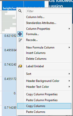

And via the GUI,  copy column / paste column is also available:

I'm looking for something that is as simple as the copy/paste column items in the GUI but for JSL.
Just dt << copy column (:name)
and
dt2 << paste column
no expr or any other JSL involved.
Maybe with a couple of position modifiers such as <after :colname>, <end>, etc.
