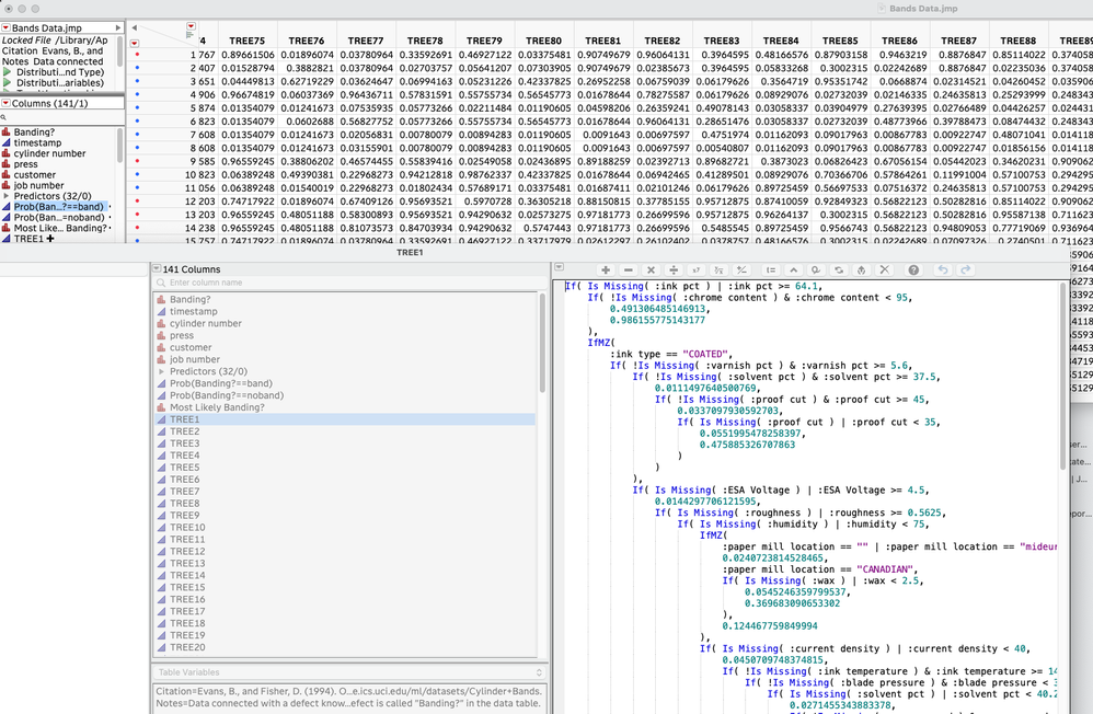

If I understand the feature you are requesting, with a little bit of JSL you split out the bootstrap forest prediction model in to separate columns.
Here is an example:
names default to here(1);
dt=open("$sample_data/bands data.jmp");
bf=dt << Bootstrap Forest(
	Y( :Banding? ),
	X( Column Group( "Predictors" ) ),
	Missing Value Order(
		Low(
			:proof cut, :caliper, :humidity, :roughness, :solvent pct, :ESA Amperage,
			:wax, :hardener, :current density, :anode space ratio, :chrome content
		High(
			:viscosity, :ink temperature, :blade pressure, :varnish pct,
			:press speed, :ink pct, :ESA Voltage
	Method( "Bootstrap Forest" ),
	Portion Bootstrap( 1 ),
	Number Terms( 25 ),
	Number Trees( 100 ),
	Go
bf << Save Prediction Formula;
bf << Close Window;
c=column(dt, "Prob(Banding?==band)");
because a bootstrap forest model has the structure
( tree1 + tree2 + ... + treeN)/N
--get the prediction formula expression
--get the argument inside the main parenthesis (the sum of the trees)
--convert that experession to character and use the Words() function to get each tree formula
as a character string into a list
--then iterate through the list and create a new formula column for each tree,
formula_expr=c << get formula;
arg(formula_expr,1);
trees_list=words(char(arg(formula_expr,1)), "+");
for each({tree, ii}, trees_list,
	ctree = New Column("TREE"||char(ii), numeric, continuous);
	tree=trees_list[ii];
	Eval(parse(substitute("ctree << Set Formula(fff)", "fff", tree)))
