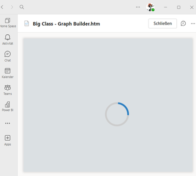

At the moment, when I want to share an interactive Jmp file via Teams or Sharepoint, my colleagues just see:
... and think that there is an issue with Jmp - or an issue with my Jmp file.
For them, it's hard to find out that actually it's a Teams / Sharepoint  issue with the interactive JavaScript code.

 for a future version of Jmp, would it be possible to slightly change the code of the interactive HTML?
Instead of starting right-away with the start animation,  the HTML code could check if Java Code can be executed and if not: show a warning that it's actually the browser or the site which prevents the page to be loaded correctly. Then it could show a suggestion to download the file and open it from the hard drive.

I have updated JMP's Interactive HTML generation code in JMP 19 to detect if the environment where the file is being opened has JavaScript disabled. If it is not enabled, a message will be displayed saying so instead of displaying the loading graphic and trying unsuccessfully to run the JavaScript code necessary to display the interactive graphs and tables contained within.
Our code cannot learn enough about the environments in which you share your files to explain how to make web pages requiring JavaScript work in these environments. Typically, the only option is to download the file and open it in a browser with JavaScript enabled.
