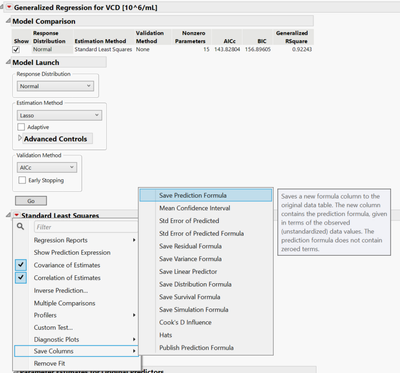

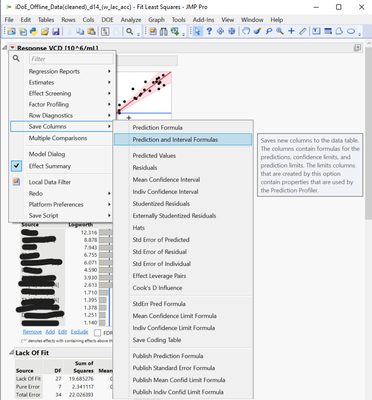

In the least squares platform, there is the possibility to directly save the prediction formula + confidence interval formulas + prediction interval formulas, with just one click (see screenshot). When variable selection is important, we work in the generalized regression platform. From there it is sadly not possible to directly save the prediction formula + confidence interval formulas + prediction interval formulas (see screenshot). Instead, the model has to be refit after model selection in the least square platform to get this benefit, which is also not possible if you choose a different response distribution than normal.

I would like to see the same functionality for saving prediction formula + confidence interval formulas + prediction interval formulas with just one click in the generalized regression platform.
