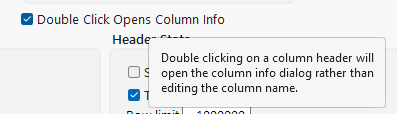

this functionality is still available.
as an alternative:
then double click on the column name to rename the column

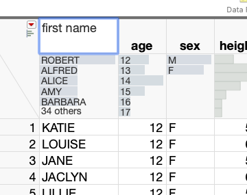

If you click on a cell, then "Clear row states", JMP ends up in a state where typing does nothing.  This was the state I was referring to.
But I quickly realized that simply pressing the left or right arrow key draws a dark border around the column header, and then typing works to rename the column.  I don't know why that's required, but it's an easy-enough workaround.
