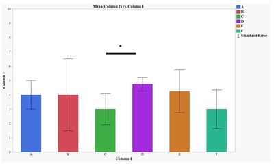

It would be helpful if there was a shortcut in Graph builder where you can import pairwise comparisons to be displayed on the graph. Currently we have to export the JMP bar graph to PowerPoint and manually add the lines that indicate significance between groups.
We do use JMPs Fit Y by X tool to do the stat comparisons and JMP graph builder to create the "base" graph. We would just appreciate if these capabilities were linked

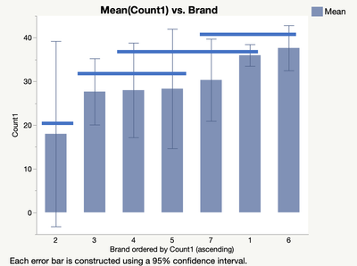

In your plot, the groups are ordered naturally (standard alphanumeric ordering that JMP uses).  Typically, for a compact overlay of mean comparisons groupings, you would order groups by their group mean.  Would that be acceptable, or would you need to specify a different order?  e.g.
Are you wanting to just do pairwise (unadjusted) comparisons or would you want to do this for other multiple comparison methods?  The typical statistical approach to multiple comparisons is to show the groups that do not differ, rather than the groups that do differ.  In your example, with 6 groups, there are 15 mean comparisons that could be made, and if you don't use the "group the similar" approach, you could have a lot (up to 15) pairs not similar and need 15 indicators on the graph.

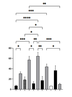

Agreed, Graphpad has a similar feature that would be useful to have in JMP. Lines or brackets can be added automatically with certain types of analysis methods (T tests, one sample t test and Wilcoxon test, and one-way and two-way ANOVA).  https://www.graphpad.com/guides/prism/latest/user-guide/simple_pairwise_comparisons.htm

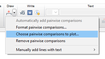

To @Mariscience's point, the GraphPad graph below shows an example where there are many comparisons + many significant differences. In a case like this, I will choose which comparisons I would like to plot (noting somewhere which I have left off and why) using the GraphPad tool also shown below. I could also exclude some bars/ groups that are not as relevant.
