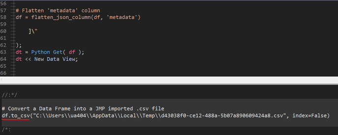

@Sarah-Sylvestre, it looks like the Python dataframe still goes via a csv to become a JMP table. Am I misunderstanding something?

JMP 14-17 Python Send ( dt )   created a copy of the data table as a pandas dataframe.
JMP 18_+ creates a jmp.DataTable object which is a live reference to the data.
Python Get ( dt ) get's a JSL reference to the Python data table object.
Python Get ( df )  creates a data table from a pandas dataframe that is a COPY of the data.
JMP 18 - Python Get ( df )  does indeed use CSV to get a DataFrame as JMP DataTable, that was left for compatibility.  You should be making a dt from the df in Python and using the dt with Python Get().
JMP 19 adds Portable Dataframe Protocol support so that it is easy to create a JMP DataTable from a Pandas dataframe in memory without having to walk the columns and build columns yourself.  dt = jmp.from_dataframe( df )
In JMP 19 Python Get ( df ) should create a new data table which is a COPY directly from the dataframe in memory.  If it cannot automatically convert in memory for whatever reason, it falls back to CSV instead of failing.
