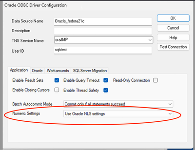

According to the Doc,
This checkbox from the driver configuration controls the NLS queries that are occurring. JMP isn't making any explicit queries to
SYS.NLS_DATABASE_PARAMETERS
Status changed to: Needs Info
