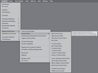

Hi @JaredEMoll ,
Thank you for posting this suggestion. In JMP 19 you can create IMR charts from the Control Chart menu, using a dialog that is nearly identical to the legacy IR chart chart dialog in JMP 18. If you'd like to give this a try, please join our Early Adopter program at jmp.com/earlyadoper.
I'll mark this request as delivered for now.
Thanks!
Mia
mia_stephens
Staff
Returning to this request @JaredEMoll , curious if you've explored Process Screening?  It's ideal for exploring multiple processes simultaneously, and has been greatly enhanced in JMP 19.
Also, the legacy control charts are still available via JSL, and the legacy control chart menu can be added back using preferences.
