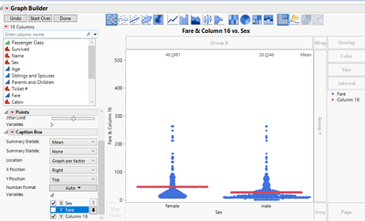

and I am looking at this chart

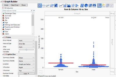

I decide that I have a bunch of data that isn't useful in this analysis and is skewing the mean so I exclude it.  The chart changes but my calculated value did not in the formula and thus the mean dots and the caption box summary statistic did not change:
So in this case I would want the formula to treat the excluded rows as missing because the excluded data is not useful in this analysis.  However, I may want to keep it for another analysis and thus recoding it to missing is not a great option either.

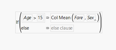

My work around has been doing something like this
but it has not always been this straight forward.
