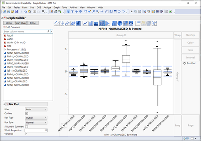

If I have a situation like this where I have multiple columns in my Y-axis for example

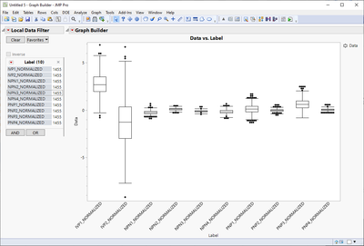

I don't have any easy options to hide or add extra columns. If I want to some of those columns or add new ones, I have to stack the data first and the create a graph with local data filter
This does work great but sometimes this feels very unnecessary step.

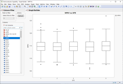

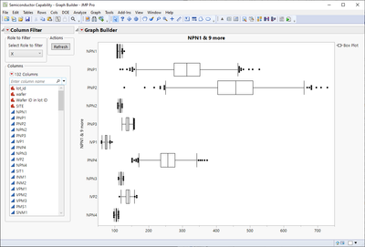

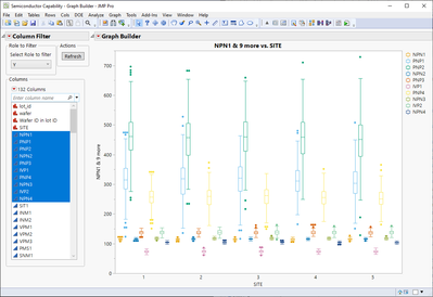

Script to demonstrate how this could work (this is very far from usable product, but should function as demonstration, I also will turn this into add-in/toolbar when I have enough time to properly design the UI)
One column at Y
Add more and refresh
Remove X role
Add two to X role
