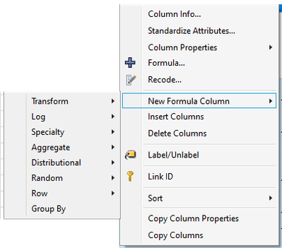

The New Formula column submenu in the column right click context menu is very useful to quickly generate new formula columns.
But the user is somehow "lost" if the desired function is not available or if he want to generate a special function.
Then he has to generate a new column, and add a formula manually manually.

But let's look at the Filter Col Selector right click context menu, e.g. by right clicking on a column entry in the Summarize Dialog.
There is an additional entry: Formula ...
which allows the user to create a "draft" new formula column, just starting with the identity formula and waiting for further user input.
What is the improvement you would like to see?
Add such a Formula ... entry also to the New Formula Column submenu of the column right click context menu.
The new column should be called orignalColumn 2
- Transform[originalColumn] (like in the Filter Col Selector) is too long :)

@Sarah-Sylvestre , thanks for delivering :
... and much more powerful than I imagined - even with Replace function!
