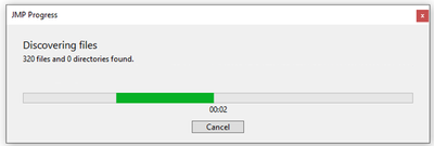

Multi file Import: Discovering Files takes too long
For files which are stored in a network folder, it's can be faster to open Python, write a new code using GLOB and use the file list as input for Open in a for loop
... than to wait for MFI to fill the file list with entries which are then de-selected by the name filter.
What is the improvement you would like to see?
Please add an Option to MFI which i as fast as GLOB:
The user specifies some filenames -> MFI finds the files (if the specs for data, size etc. are disable, there is no need to invest minutes to get this data. get it when the user activates one of the specs)
And Don't do it vice versa:
find all files in the specified directory, read the date, file size, etc. and then find out that just 2 of the thousand of files in the list match the filename spec.

Jmp 18 will have an option to select files manually:
... preventing Jmp from
... and
time to run the same script:
Jmp 17: 37s till add data is loaded
Jmp 18: 7s
thanks :)
hogi
Level XIII
Thanks you sooo much, such a speed improvement:
  1. Pick Files via FilePicker -> use
  2. run MFI with <<Set Use File List( 1 )
hogi
Level XIII
@Sarah-Sylvestre . Thanks for implementing this feature in Jmp18.
-> delivered :)
