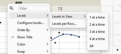

how about adding a "levels in view" option to page - like it is available for Group X and Wrap
then the ata filter right next to THE plot an the user can zap through the plots with the arrow keys:
hogi
Level XIII
Fun fact:
It's already possible to activate "Levels in view" for Page:
- use it for wrap and drag the variable onto Page
- via Scripting:
Graph Builder(
	Variables( Page( :name, N View Levels( 1 ) ) ),
But I don't have a clue how to cycle through the pages
