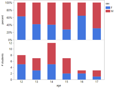

A test data set to check if it's working as expected:
The plot should show the counts of the students 2x.
a) as percent. labelled "percent"
b) as counts, labelled "# student"
After saving and reopening the script, the graph should still look like this:

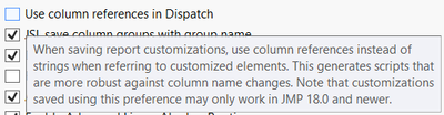

with the option disabled,
the generted code looks like this:
