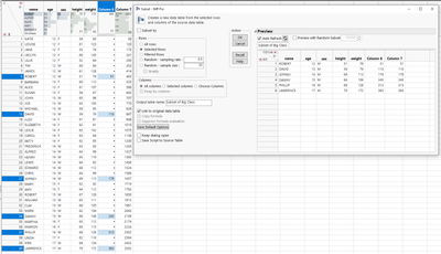

Let us add formulas to linked subsets which would then provide the values back to the original table. If the row is not in linked subset all the values should be empty and otherwise they should be calculated based on the linked subset. We can do this basically without formulas, if we add index column and update values back to the main table but formulas makes it more visible what is being done.
Below is one example:

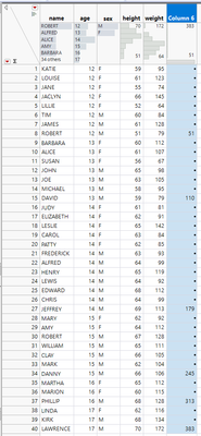

We wish to calculate cumulative sum of the last height of each age.
We can calculate it with a formula such as (which is unintended but one of the best formula features JMP has Make using formula expressions in Set Each Value and using expressions as first argument in Col stat... )
If(Row() == Col Max(Row(), :age),
	Col Cumulative Sum(If(Row() == Col Max(Row(), :age), :height, .))
Now if we were able to use this "linked subset reverse formula" we could take a subset of those values (many ways to do this). Just by having the formula in original table
Col Cumulative Sum(:height)
and looking at the preview, when we have link to original data table enabled, we can see that it calculates correctly (Column 7).
I would somehow like to be able to add this "subset" formula to my original table.
When I click OK, it reverts back to original values and calculates "incorrectly". This is bugged either in preview or in the subset. I would prefer to have it like this in subset BUT I think it would require some additional option added as it isn't same value anymore as you would find in the original table.

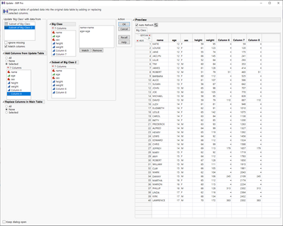

Currently I can create NON-LINKED subset with copy formula and then use update to add that back to my original table (first change column name) but this way there is no more indication how those values were calculated (unless I script the whole thing / use workflow for a bit clunky documentation)

To get the column to the main table, actually, there is no need to use Update. As the Tables are linked, it's enough to drag the column there:
(view in My Videos)
but like with Tables/Update: you will lose the formula behind it.
