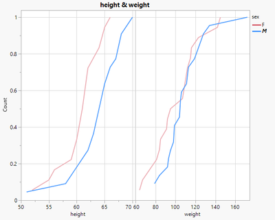

Example w/ data from Big class.jmp
Minitab: Automatic settings, 3 clicks in dialogue window
jmp (no JSL, just std. options)

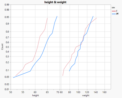

1. Graph Builder
Automatic settings
y-axis manually set to Probability Normal and adjusted to 0.01 and 0.99

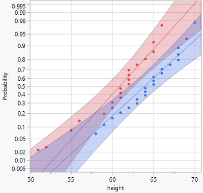

2. Lifetime Distribution
Automatic settings. Nice graphics, but
- No panel option
- No info about distribution type (Normal, Weibull,...) and CI
- Legend missing when copied w/ "Copy Graph" (available in original report)
Summary: Such graphs in the graph builder w/ the above issues fixed would really be appreciated.
