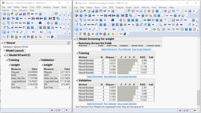

Here is an example for Neural, using Model screening I can see the fold but not in the actual platform.
This would be a great help for JMP Standard users (in Neural) and offer more flexibility for Pro users who want to be able to use the expanded feature set in the native platform.
I would like to see this for Neural, Bootstrap and Boosted forests, and SVM.
