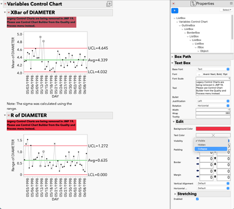

Hi @ConvergentTree1 , thank you for your request. The Legacy Control charts will be retired in JMP 19, hence the red banner in JMP 18.  However, most of the legacy functionality is available in the control charts under Quality and Process > Control Charts (including launch dialogs).  Please let us know if there is any legacy control chart functionality that is missing from the newer control charts.

I understand. There is a JSL command in JMP 18 that removes the banner: Send the command, {Visibility( "Collapse" )} to the textbox.

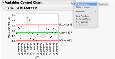

Saving as a Platform Preset might do the trick.
First, use properties to change the visibility of the banner to Collapse (open Properties, and click on the banner, to see banner properties - visibility is under Edit), and repeat for the second banner.
Then, save as a Platform Preset (here, I've saved as No red banner). You can apply this preset any time you launch this control chat platform, and you can share with others.
See https://www.jmp.com/support/help/en/18.0/#page/jmp/platform-presets.shtml# for more info on using Presets.
Please let me know if this works for you.
