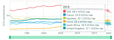

I fear that a delay for Hover label will make it feel "laggy".
There are nice examples on the net how exciting a "live" hover label can feel:
https://wid.world/world/#lpfghg_p90p100_z/US;FR;DE;CN;ZA;GB;WO/2020/eu/k/p/yearly/l/false/3.516/100/...
perhaps:
don't update the content if it's exactly the same as before?
just:
place the existing Hover label at the new position.
