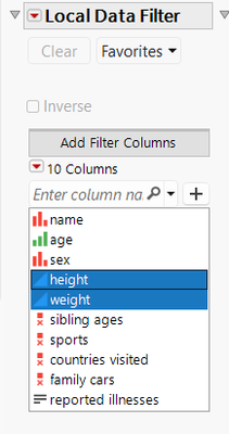

cnames = Current Report()[listboxbox( 1 )] << get selected;
rowindex = dt << Get Selected Rows;
dt[rowindex, cnames] = .;
The fist ListBox in the report is used to specify the columns. It's quite universal, it can be a Column Switcher, a Local Data Filter or the standard Column Menu of Graph Builder:

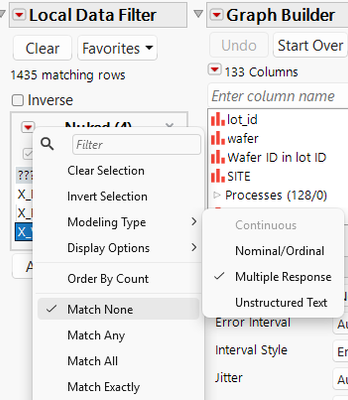

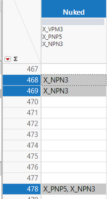

The information about nuked cells is stored in a column Nuked with property Multiple Response:
To nuke a cell in column XYZ and row N , one has to add "X_XYZ" to Nuked in row N.
In the examples, for row 478, the values of columns PNP5 and NPN3 are nuked.
This information can be used in a report - by using the column Nuked in the data filter - with the option "Match none":
A user who wants to nuke outliers in columns PNP5 and VPM3 can select the entries in the data filter:
