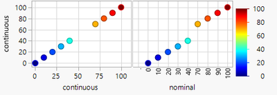

hogi
Level XII
yes, something like lock scales would be great. If it locks the scales : )
issues with nominal values:
  1. poor( often:  non-acceptable) quality of the tick labels:
  2. the numbers loose their "meaning"
    e.g. if there are no data points at 50/60, this should be visible as a gap on the x axis.
    With nominal values, the gap is removed: after 40 follows 70:
    For this part of the issue, Column Property: Inclusive/forced Values (💚)  in JMP19 will be a huge improvement.
