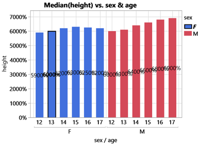

In GraphBuilder, there is an option to add labels "by value" directly inside the graph.
Unfortunately, there is no option to adjust the orientation of the label. Therefore, labels are sometimes hard to read:
How to rotate a label?
What is the improvement you would like to see?
For axis labels and annotation text, there exist options to adjust the orientation.
Please implement a similar option to adjust the orientation of "labels by value."
edit:
Please also add an option to control the placement:
Graph Builder Bar Graph Label Offset
Why is this idea important?
Labels in Bar graphs are often not readable and via the GUI the user doesn't have a chance to fix that.
Just some JSL experts can generate graphs with readable labels.
[the issue got more severe in JMP 18 doe to the new way of label placement]
With the new options, any user could make the labels readable

A trick which I just learned from @Byron_JMP  at https://community.jmp.com/t5/Byron-Wingerd-s-Blog/Graph-Builder-Bar-Graph-Label-Offset/bc-p/777978/h... :
DispatchSeg(	BarSeg( 1 ),	Set Font( "", 18, "", 90 )	)
cool, -> hits the nail.
So, please add a setting in the GUI which implements this trick in the background.
Besides that, it seems that with JMP 18 we lost the chance to put the value labels to the center of the bars.
As an add-on - following the idea of @Byron_JMP 's blopg post:
-> please also add a control for the placement of the labels
- above the bar [default]
- on top (inside bar)
- center of the bar [like it was possible in JMP 17]
- at the bottom
