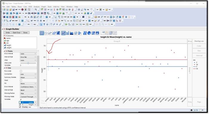

I use line charts a lot without using the X element, so that the line goes all the way across the chart and shows some summary value, usually the mean. I started to try and put in the CI error bands to show if they overlap but found that the current behavior of JMP does not work as I expected.  Here you can see the error bands are just a sliver on the left side of the chart.
What is the improvement you would like to see?
I would like to see the error bands go all the way across line element.

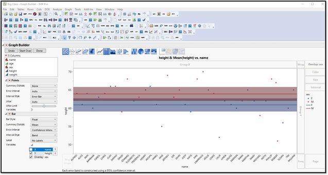

I could make it look like this by using the bar chart element and making the width of the bar and band=100 but it shouldn’t be that hard in my mind.
