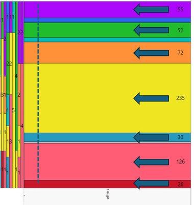

"bar chart label control"
besides specifying the vertical position along a bar, like discussed in Graph Builder Bar Graph Label Offset , please also provide a way to  specify the "alignment":
- "centered"
- "left"
- "right"
- distance to 0 ?
to get nicer looking graphs:

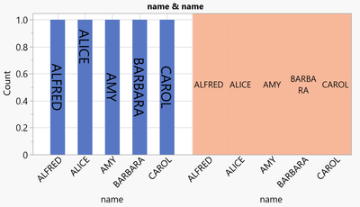

besides bar chart, please also add an option for Heatmap plots to move and rotate the labels.
plot on the left: bars - like expected
plot on the right: heatmap - no effect
gb = Graph Builder(
	Variables( X( :name ), X( :name ) ),
	Elements(
		Position( 1, 1 ),
		Bar( X, Legend( 3 ), Bar Style( "Stacked" ), Summary Statistic( "N" ), Label( "Label by Row" ) )
	Elements( Position( 2, 1 ), Heatmap( X, Legend( 5 ), Label( "Label by Row" ) ) ),
	Local Data Filter(
		Add Filter(
			columns( :name ),
			Where( :name == {"ALFRED", "ALICE", "AMY", "BARBARA", "CAROL"} )
fbs = gb << xpath("//FrameBox");
fbs[1] << DispatchSeg(	BarSeg( 1 ),	{Set Font( "", 18, "", 90 ), set label offset({1,1,0.8})}	);
fbs[2] << DispatchSeg(	RectSeg( 1 ),	Set Font( "", 18, "", 90 ));
fbs[2] << DispatchSeg(	RectSeg( 1 ), set label offset({1,1,0.8}));
